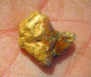

    I got mine early in the season, took it to a patch of bedrock and found a nice, thick, fat and sassy nugget the size of my thumbnail. It was in an area of bad mineralization that some VLF'ers had already hit, but that 5000 sure sniffed it out. I had it set on deep gold, using a DD to handle the hot ground. It had company too--three smaller ones in the vicinity.
    The only problem I'm having is that there is so much more to know about the machine's capabilities, and the different outcomes you can get using the various coils for it.
    It's heavy like all the other big Minelab gold machines, but I use Doc's Swingy Thingy and it makes things a lot easier. It works well in concert with other detectors nearby--you just auto-balance it for electronic interference and it shuts them out. I was even hunting side-by-side with by buddy that was using a 5000 as well, and it tuned him out too.
    It's a very quiet machine, and with a small coil, extremely sensitive.
    I like it. And, having said that, I've bought other expensive equipment, and have not liked it, so I'm not afraid to say if something disappoints me--this machine (the GPX 5000) impresses me. The thing I'm not very impressed with is the wimpy nature of the discriminator--I think that's an area that Minelab could really put some research and development in to making it an exceptional machine. Their little 705 X-Terra that I have has a fantastic discriminator, so they have the technology.
