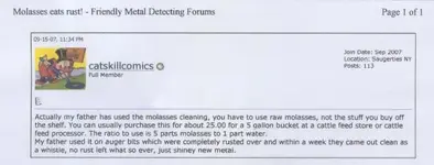

My experience, so far, is with copper pennies only. I decided to share that in the next paragraph below, just FYI. But as far as the 1943 and '43D war time pennies, I can only offer references to what I have found on the web about the use of Molasses for cleaning rust from steel, beginning below at paragraph #4. Lastly, I attached a post from another forum, which I thought was interesting (note that this post recommends a 5:1 ratio, rather than the 9:1 indicated in the metalwebnews report at the web address address below.).

Paragraph #4 - This address: http://www.metalwebnews.com/howto/rust/rust.html takes you to a report that is very enlightening, but the subtitle Removing Rust and specifically paragraph #11, beginning with "I read of using a solution..." deals with the subject of using Molasses to clean rust from steel.
After reading a lot of material on the web, I ran across a term associated with the use of Molasses, called "chelation" and another statement that said molasses is a chelating agent. So, I went to the page dealing with this term on Wikipedia.......it was a bit too scientific for me to comprehend. I wish someone could give us an explanation in simple-to-understand language.
In addition, I discovered that molasses is made from different things, most commonly sugar cane and beets. When made from sugar cane, there are three grades, first molasses, second molasses and Black strap molasses, and these grades can be either sulfured as a preservative, or non-sulfured, according to the Wikipedia, tab titled Molasses at: http://en.wikipedia.org/wiki/Molasses. Click-on this address if you want to go there to review that information. I haven't found anything suggesting that any of these three grades are considered synonymic with "RAW" molasses, which is the general term used in suggestions for cleaning rusty steel. Can anyone clarify this ? Secondly, which one, i.e. first, second, Black strap or RAW, would be the most efficient for cleaning rusty steel ? Or would something like unsulfured Grandma's Molasses, available in grocery stores, work just as well ?
