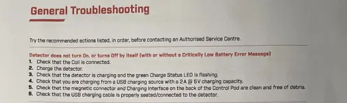

Also check out the trouble shooting guide on page 67 of manual.
