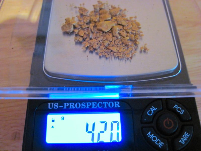

It doesn't go deep, but it's exceptionally sensitive. It's a real gold hound for small gold, but it screams on nuggets too. It howls on hotrocks like crazy. So, if you're looking for something that you can use to test dirt where it's dry (no water for panning), the Falcon will plow through your spread out sample and let you know if there's any specks of gold in the dirt. (I used a magnet to drag out most of the hotrocks though--that way the machine wasn't howling all of the time at the positive and negative hotrocks in the pan--saved me a lot of grief.) I used it on bedrock that had already been worked, and it was amazing at what it sniffed out--we had a lot of fun with it. Some guys never go prospecting without it.
Here's a shot of what I found with it.
