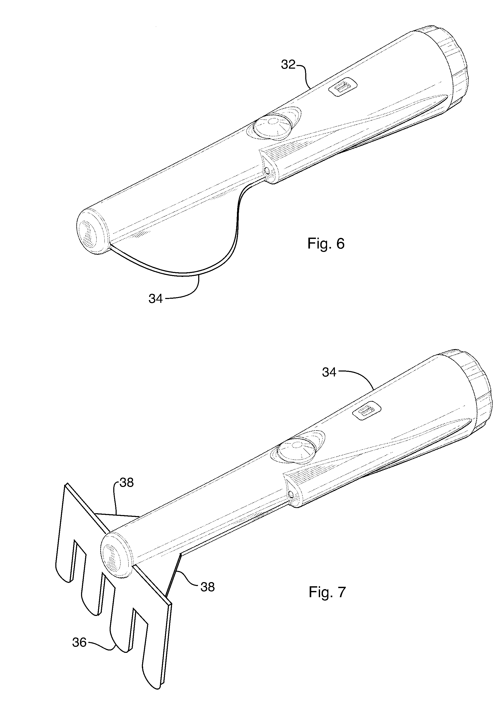

    While trying to find your answer, I looked up the patent number listed on Garrett's site here.
    Here is the google patent page here.
    and an image of the Propointer AT that I thought was interesting.
    From the information provided, the Carrot operates on 11.5 kHz (which is VLF) but does not require movement which indicates Pulse Induction.
    Honest Samuel likes this.
