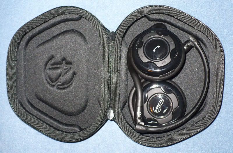

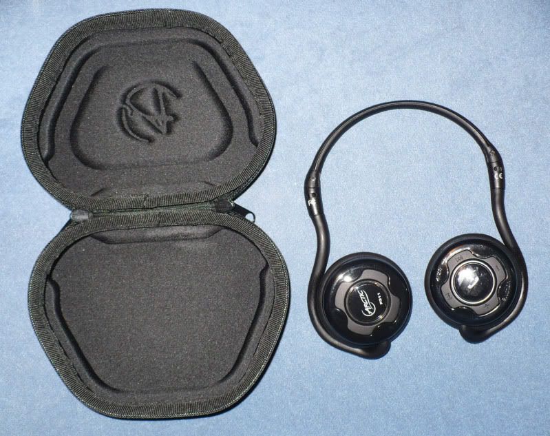

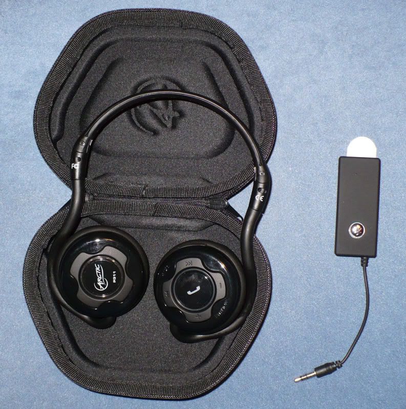

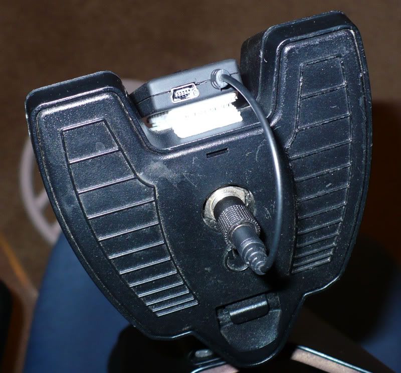

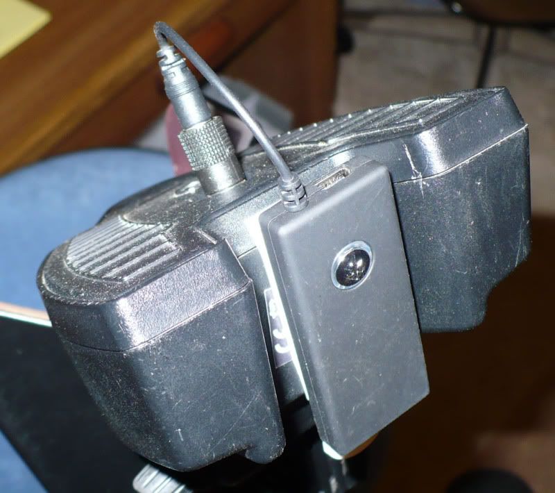

Went for a 2.5 - 3 hr hunt today using the new Bluetooth setup. All I can say is "WOW!" This is everything and more than I had hoped for. I've taken a few pictures to give you a better idea of how this is arranged. The headphones are designed by a Swedish company and (of course) made in China....the brand is Arctic Sound, www.arctic.ac and the model number is P311. They come with a USB charger and a padded hard case with zipper closure.....the headphones have to be folded to go in the case, no biggie. Keep in mind, these can be used with everything from an iPod to the tv as long as the device has a 3.5mm headphone jack or adapter for the dongle.
Headphones folded inside case:
Headphones unfolded outside of case:
Headphones, case and dongle: (the white tab at the bottom of the dongle is the pull tab for the 3M Command mounting strip)
Dongle mounted to the bottom of the battery compartment on my Fisher F75...you can see the USB charging port:
Another view of the Tx dongle viewed from the bottom of the battery compartment:

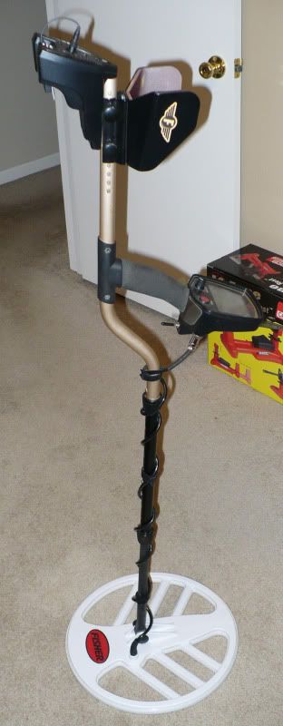

Freestanding F75 on the Fisher 15" DD coil:
