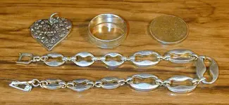

When I use the detuning, it doesn't give a gradual signal increase, but goes to full strength at the distance I've chosen. With the horizontal bar, I set it so it won't trip the signal when scrubbing along the woodchips as long as I don't raise the coil. This gives me at least a 3 to 4" detection depth in the chips. Today I found the bracelet in the attached pic with this technique. When first running the MD around the area without detuning, the bracelet didn't show at all. I also used that technique when I found the diamond ring I posted a while back. I would not have found it otherwise. Just changing sensitivity isn't the same. It's not as effective as detuning. I've tested it both ways. On that day, a guy in the park told me someone had just detected the totlot an hour before. I said, "Okay but I think I'll go over it anyway." My best find ever was the only thing besides a piece of foil I found in there that day. The earlier MDer obviously stayed clear of all that metal.

I also got a wheatie, small ring, and small silver pendant today. Wheaties are a rarity in my local parks. HH
