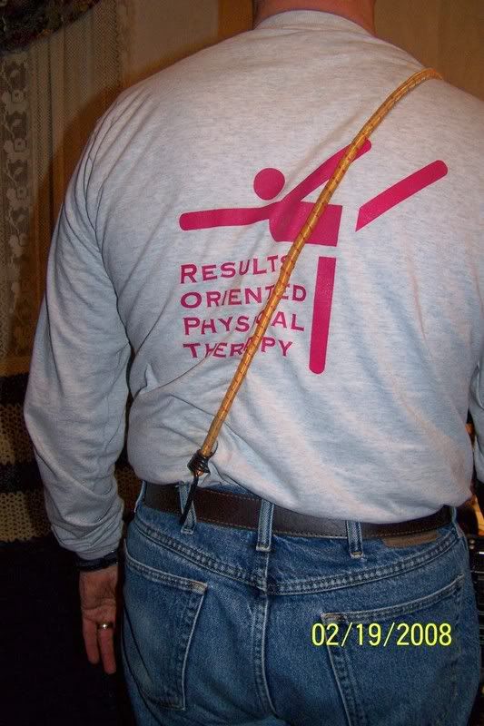

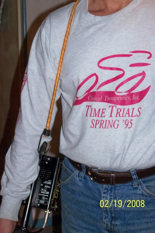

OK, here is a cheap and easy support to lighten the weight of your DFX.
Use a regular bungie cord, they come in different lengths. I use one that is 38" long. If you are holding your DFX with your right hand hook one end of the bungie cord around your belt on the left side of your backside.
Bring the bungie cord up over your right shoulder and place the hook on the other end of the cord through the hole in the arm cuff on the DFX.
Depending on the length of the cord that you use you can almost make the DFX float. It is not as nice as those expensive straps you can get but it works pretty well.
I like the looks of that and the price. Will try it on my MXT this spring. My one only complaint on the MXT is the weight after swinging for several hours, especially with the larger coils. I can see where several cords of different lengths my let one adjust the amount of support as well.
