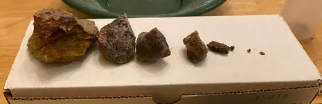

Had a bunch of rocks ready for when Amazon dropped off my falcon. I've been wanting to get a better handle on the iron oxide stained quartz rocks and other iron heavy rocks in my streams, so have been looking at the MD20 for over a year.
I think that it will be my favorite tool. Although, can't say that I entirely understand why the Falcon identified some of the rocks as containing nonferrous metal. See attached pic.
-- First and fourth in row were straightforward. Crushed part of the first and found insanely fine gold (I believe). Could barely see the flecks with 50x loop. Will have to revisit these guys to crush/examine a larger sample.
-- Second and third are head-scratchers. They are super light like dried clay (kaolinite??). Impregnated with dark purple, green minerals. No idea what's going on here.
-- Sixth is a steal BB, I think.
-- The rest are attracted to magnet. Even so, Falcon identified these as containing nonferrous metals. The last two are similar to metal that I've found associated with chunky magnetite. Biggest sample (not shown here) was .3 grams, had specific gravity somewhere around 12 to 14. Metal is malleable but not easily deformed. Takes a fair amount of effort to squish it.
