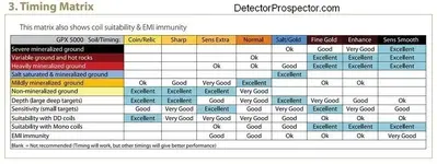

I've been reading and it seems certain timings are better with a certain type of coil. i.e DD or Mono.
Mono is best with Fine, enhance and Sen Smooth. And DD coils are best with Normal to Relic.
My question is, Is their any legitimacy to this below picture?
The whole suitability with DD vs. Mono has to do with what thise timings are used for. You can't really use the table "in isolation" as there is an implied assumption as to why you are using a particular timing. Coin/Relic has minimal ground compensation, therefore, it is going to be the deepest in non-mineralized ground. Also, the presumption is that you will want to be able to make use of iron rejection if relic/coin hunting, which is only possible using a DD coil. That is why that column does not indicate anything for the Mono coil suitability. The DD coil is standard and can be used with any timing. ML seems to imply the Mono coil is good for the less aggressive timings to the right. I think all that is going on there is that you start becoming depth limited in highly mineralized ground so the mono coil gives you maximum depth vs. the DD. Does that mean a mono coil cannot be used for the more aggressive soil timings on the left? No. But if you also want iron rejection there, a mono will not give you that.
Note also that coil size matters as well as your intended target composition (not just size) and neither of those consideratilns are mentikned in the table. Fir more detailed information go to the website printed on the top of the chart where that inage was lifted from.
I understand thanks :)
