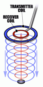

Hi folks just located this info on the net
How They Work
There are several different types of metal detector technology, but the one that is the most widely used is Very Low
Frequency (VLF). VLF is also called induction balance, because it uses both a transmitter and receiver coil, which
analyzes signals that are induced by the detector's current oscillation.
Search coils are key components when it comes to finding buried metallic objects. They come in various sizes, and all
will have actually two coils that work together. The transmitter coil is the larger outer coil loop. When activated,
electricity is sent through the transmitter coil in alternating directions thousands of times per second, which generates
a magnetic field. The number of times that the current alternates establishes the frequency of the unit. As the coil
pulsates it changes the polarity of the magnetic field. The magnetic field is constantly being projected down into the
ground and drawn out again. As the field comes into contact with conductive objects it causes them to generate weak
magnetic fields of their own.
The receiver coil is the smaller inner coil. This coil is totally shielded from the transmitter coil. It serves to pick up and
amplify the frequencies being reflected back from target objects. Once an object returns a signal to the receiver coil it
is amplified and sent to the control box where it is analyzed as to content and depth and the results are displayed.

Search Coil
The search coil is the component that actually senses the metal. Search coils are also referred to as the "search head,"
"loop," or "antenna."
