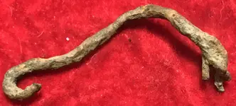

Some Items From a Trade Era Site, I'm working on cataloguing my finds and ive yet to get a good id on these objects, the lightning bolt thing ive seen in pictures of trade objects but I dont know what they are, and the funny looking naillike object with a flat side I suspect may be a trigger. any help would be appreciated
Your "lightning bolt" piece is a double ended awl........Is the piece in the bottom picture silver? If so it could be part of an armband.
The rest of the pieces are pretty subjective....... Hard to tell......especially without handling.

The lead items are odd because they were something worth printing a design on. The awl is diagnostic of trade sites, a good piece of supporting evidence to my date, the other may be gun parts I suspect a trigger and the other maybe a nipple wrench

It is hard to tell from the photo, but I don't believe the iron relic to be a trigger. Could be but just can't tell by the photo.

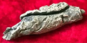

Here’s a roll of lead that sure looks like “junk” but now thanks to this site I think it may have been wrapped around a hook

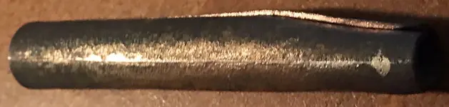

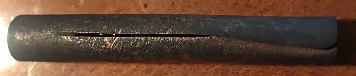

Just for the fun of it, found same spot, brass. Gun related? Or even just what is it?
No it’s a tube that has a clean cut most of the way across but not all the way
Could be a collar that held in place the bit attachment for a Ramrod. Use callipers to check the rough caliber and search 18th and 19th century long guns used in the fur trade
I don’t think I’m following you exactly are we talking about a ramrod thimble/holder or a different piece like this
That last piece, was wondering if it was just a sleeve that held tight the receiver of the ramrod tip ?
