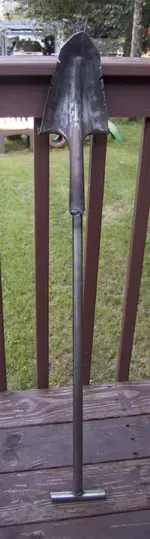

My old was made from a very cheap shovel and broke after a few months of heavy use, so I got a regular old (but quality) shovel from my boss. He broke the handle and had no use for it.
I drew the shape and size that I wanted, then cut it out with a cutoff wheel, then welded it on to the T-Handle that I made for the shovel that broke.
I really like the way it turned out, and it's SUPER strong!
Nice shovel...and, ummm,...your avatar is just wrong. Funny,creepy..... and wrong.
Aye, thats a fine shovel and a disturbing avatar! :laughing7:
Very nice. Thanks for sharing.
Talent at its best
Is it heavy ? They made shovels to last back years ago. Nice job.
Great job mr.Helton!
Awesome, I was just thinking about making something like that, just got a new welder in the shop
Nice shovel.

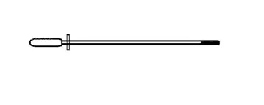

I want one like this:
Narrow blade - 2-1/2" wide by maybe 8" and a rugged cross bar a foot from the tip. On a shaft (ash or tubular metal) long enough to act as a walking stick. Serrated on one side for roots. Thick, folded or ridged blade that can be used to lever up a plug or snap a small root without bending and the cross bar for foot power assist. A boar-spear rugged super trowel.
Most people see you with a shovel they're afraid you're going to be digging fox holes on their property. This is a coin & button shovel for little holes a foot deep - maybe even just plugs.
It looks good I made a similar one out of an old GI shovel. One suggestion I have is if you can widen the top T part where you foot goes it may help. My foot was killing me after the first few hours of using it. I have since added two pieces of angle Iron to it to make it about an inch and a half wide.
