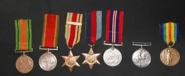

Hi Guys,
A friend of mine bought his collection of medals to me, these belonged to his Father and Grandfather. They really looked tatty, and were going to be given to his grandchild when he grew up. I took it on myself to help him out and fix these up a bit.....
These are a before shot of some of the medals.
I removed the ribbons and washed and ironed them, cleaned up the medals using a Silver cleaning plate which works wonders, and for the others a drop of lemon juice.
Then I sewed on the ribbons again, and placed all the medals onto a frame.
Here is a photo of the Silver cleaning plate. It uses the plate, washing powder and water.
Thanks for looking and God bless
