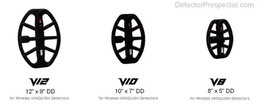

I would like to hear which coil you preferm and why.
I kve both the V8 and V12 with my Vanquish 540 Pro Pack and I think I will use the V8 mostly at the beach detecting.
I know the V12 will go deeper but probably won't use it much as I say today. :laughing7:
I haven't receive my Vanquish yet and have to wait until Friday 1/8/21. :hello2:
I also see the V10 is a good all around coil and probably will try and pickup one in the future but I will wait and see what you all say.
Thanks All.

The V12 is great for coverage of large areas. I like all 3 coils. Tools in the toolbox...
Also have the pro pack. The V8 makes it a joy to swing because of the weight. Feels like you could swing it all day, but I worry about losing depth. The V12 is a tad nose heavy but on par with the Nox and the 11 inch coil. I tend to leave the V8 on and grab it for really trashy spots where the Nox might struggle to separate. I would use the V12 if I were hunting a cleaner field or yard to make sure I could hear those deep silvers.
As most that have a Vanquish 540 everyone is questioning which coil to use and/or which is better.
Fields, Beach, Trashy areas all must be taken into account on coil selection.
At the moment the V8 coil does a great job for all around when compared tothe V12.
I know you can cover more ground with the V12 but for now it looks as if the V8 coil will suit my needs.
I was looking around for more information on how the V10 coil does but it seems they are SOLD OUT or limited supply.
Haven't seen any test between the V8 and V10 so I guess I will wait and see what happens in 2021.
Been waiting for V8 vs V10 also. All the reviews I've seen of the 340 and 440 seem to suggest it is fairly deep. It is probably and inch deeper than the 8 and an inch shallower than the 12. The 8 is 1.5-2 inches shallower than the 12. The V10 might just be the best all around.
I own a minelab vanquish 540 pro pack. I haven't used the 8" coil yet but intend to on my next outing. What is your opinion about the 10" coil. Is it worth buying as well.
How much depth are you getting out of the 8" coil. Are you getting better readings. Have you tried the 10" coil
I'v had my 540 pro pack for 8 mos. I started out strictly using the 8" coil because I had very little MD experience. I was loaned an older, Whites machine my nephew had and using a knock-off carrot pointer and dug far too many large "excavations". When buying the 540, I figured if the target was anywhere within the footprint of that V8" coil, that would cut my digging in half!
Well my first trip out with the 540 and V8 coil I dug an IHP at 8" deep in hard packed soil. I quickly got the hang of the 540's built-in pin-pointer and that cut way down on the size of my plugs. I was consistently locating stuff at depths from 8" - 10". You will definitely pick up lots of deep targets and yes this will include iron, especially old nails and bolts.
I hunt with two partners both of whom use Nox 800's. They were impressed with the 540's depth but insisted I would do much better with the V12 coil in open ground. So I took the V8 off and started with the V12. I struggled with the V12 the first time out and seemed to be returning to digging large holes, apparently I had not yet mastered the pin-pointing with the V12 coil. About mid-day I took it off and put the V8 coil back on because we were on a prime old homestead and time was flying. I quickly dug a G.A.R. 1892 encampment medal at 12" deep. The medal was made of aluminum and the signal was banging at 12" deep. I almost discarded the medal at first because it was unidentifiable. It looked so much like a token or coin I thought I better hold on to it and only after cleaning it some did I realize what I had.
Eventually, I learned to use the 12" coil and can pin-point very accurately with it too. I have dug targets as deep as 14" with the V12 coil including an 1864 - 2 Cent piece found 13" down, again in hard packed clay type soil.
I like the V8 coil for swinging in the woods now mostly. I may try it on the beach this year as well. The V12 was tough on the beach because the target seems to keep moving around and is tough to find. I was lucky to find a 10K gold ring on the beach with the V12 so I'm not complaining. I regularly switch both coils out depending on where I'm hunting. The best way to figure things out is to be out there doing it as much as possible.
I guess where I'm going here is; each coil has a place in the arsenal which brings me to the V10. I think the V10 might be the ultimate all-around coil which could eliminate the need to change coils so frequently. I will be buying the 10" very soon and will report after trying it out.
By the way, I have held my own with the 540 up against my two partner's 800's sometimes even doing better at the tailgate wrap-up. The Nox 800 will likely be my next detector but I'm not in any hurry and I don't think I could have picked a better first machine.
