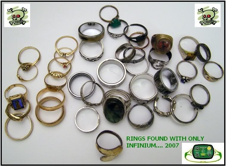

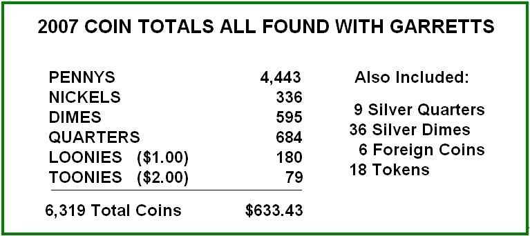

It was another generous year using my Garrett metal detectors.I got most of my coins using the GTI 2500. The imaging feature makes coin hunting so much fun and productive too. The ACE 250 and GTP 1350 also helped bring my totals up. The Infinium really brought up my quarter totals, just vacuuming those coins out of the water and sand. Most were very deep too. I have lots to be thankful for. My family, who wish I spent a little more time at home yet support my hobby, my health which is a gift and the wonderful friends on these forums. I hope we all have another good year in 2008.

Where it worked best for me was in hunted out beaches where most of the targets had been removed. The best beach hunters dig ALL targets. The Infinium isn't for everyone, and is not a do it all detector. But if you give it the time it deserves to learn it properly, and use it in its proper environment, it is a killer. I have my best gold ring year ever in 15 years using this machine.
