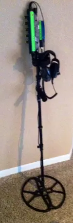

NEL 15" Attack coils available if anyone's interested. Stable and deep for water hunting.
Much deeper then the WOT and runs smooth in the water. Pulls deep targets in comparison to my dualfield pi.
Very impressive hunting on these sanded in beaches of south Florida. ImageUploadedByTreasureNet.com1439423704.766294.webp
