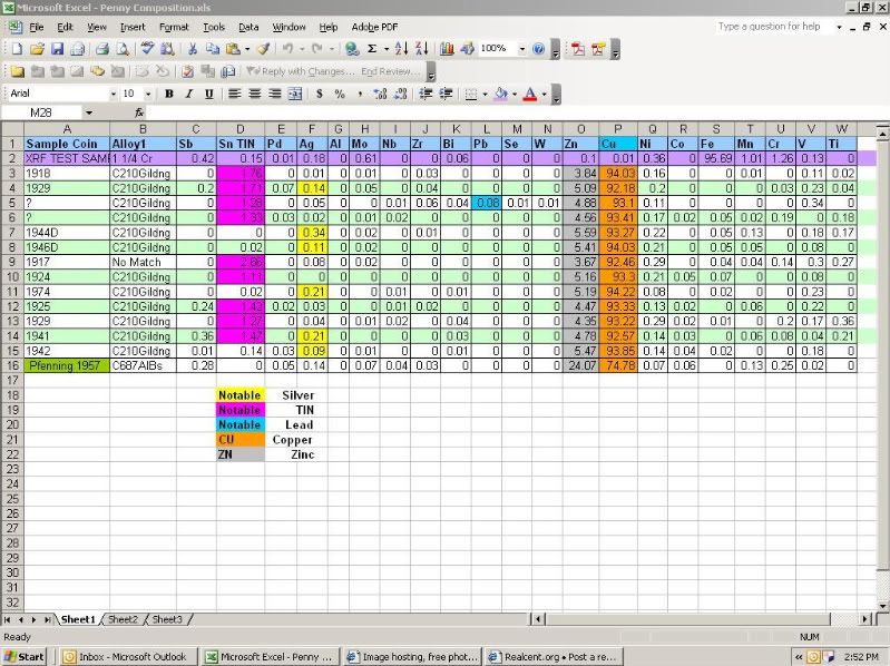

This is why the machine "rejects" some coins. It is reading the master/sample/reference coin, and compares the electronic signature to all the moving coins, note in the attached image all the different metals in old coins. There are many coins from the 70's that are also rejected. The industrial process simply could not remove the trace metals, and somehow this changes the signature of thes coins enough for the machine to say .....Not copper, or "not like the sample coin" every sheet of starting stock the mint received, could have been slightly different. The later years, like the 1979 through 1982 seem to be the most stable as far as consistency. Once you know how the machine is working, you can use it to your advantage, and even make a concentrate of "not perfect coppers" and "not perfect zincs" which will usually contain many of the more interesting wheats. For some strange reason though, the IH pennies like to hide in the zinc. I guess they don't want to be captured and would rather stay in the wild. :dontknow:
