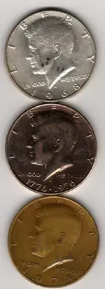

Found some similar finds this week. First is silver for reference, second is plated , looks silver / pinkish when held to the light. Third one, I'm not sure but may be gold plated?

It is most likely plated. I Have a 74 with the same problem.
