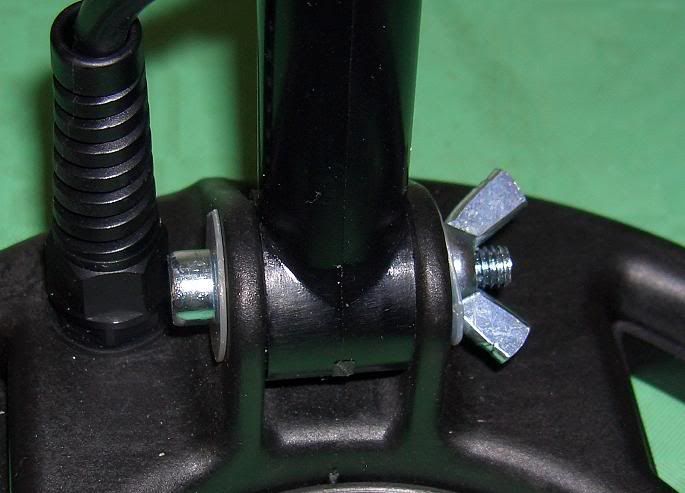

I got my Fisher 1236x2 yesterday and I'm very happy with it except that I scrapped the Nylon bolt and wing nut that holds the search coil in place.
Anyway, I did my best to locate a plastic bolt and nut (toilet seats etc) but ended up having to buy a metal bolt and wing nut.
Now, I have not noticed any difference detecting objects (coins, radiators etc) in the air, or so it seems, but I was wondering whether anyone had some better insight into this and whether it will actually make a difference.
I presumed the theory was that since the MD has to be in motion to detect a target, and since the bolt/nut are as one with the search coil, it wouldn't make a difference.
Your thoughts, please.

Update:
I've just been on my first trip to the beach and found that the pinpointer would not work, not a peep. I got back removed the bolt and now it works perfectly.
So that's one drawback.

I just turned on the MD and the pinpointer is working perfectly even though I've got the steel nut and bolt in place! Maybe it was a loose connection or the magical powers of my German friend who was messing with it last night.
Tommygunn, this has been covered before and it should make no difference. All the early Whites used metal bolts. I'm looking at an old Whites 6000 DI Series 3 right next to me with a metal bolt and it works fine in all modes as long as it is a motion dependent detector. Good luck, Rob

years ago all Tesoro's came with a metal metal bolt with nylon nut. A few years ago they switched over to the all nylon versions.
I never had any issues with the metal bolt set up but it does stand to reason that no metal should be near the coil.
HH
Many older detectors in the 1980's-90's used STAINLESS Steel screws /bolts in their coil stem attachments..The plastic 1/4 inch nylon bolts are 100% anti metal but dont stand up to elements all too well ,..best to have extras.. FWIW.. BtKidd..H-Hing
Stainless steel works pretty well as a coil bolt. It also doesn't put off much of a signal (hard to detect in the first place) and will last near forever. ..Willy.
