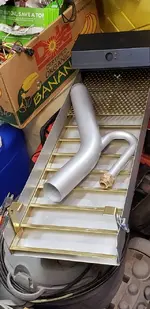

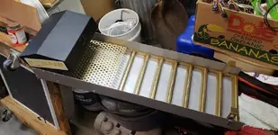

I picked up this keene sluice with attached crashbox and a 2" suction dredge nozzle on OfferUp for $200. I cannot find anything that looks exactly like it on Keenes website. It looks brand new with only signs of storage. The sluice is 34" long. Best I can tell is it looks like the top sluice of a highbanker setup? Or could this be used in a dredge? I'm pretty sure I got a good deal. But what should my plans be for this? 20180531_162911.webp20180603_104213.webp
cool find.send a picture to pat at keene.

That is a old school dredge box. I have the same one and love it. Don't look like it's ever been used. Good score
here's one I had, siting on an inner tube
Looks like I did pretty good. What should i line the bottom with? Under the riffles...

What is the purpose of the hole in the downstream side top of the crashbox? Looks like a flapper valve of some sort
The flapper on the crash box is for running a rod into the suction line to break up plugs.
the one I had just had outdoor carpet under the riffles and a 10" x 10" piece of miners moss
with some expanded metal held in place when the punch plate was screwed on,
I had a long piece of PVC to go in the plug up hole, instead of a flap it had a boat drain plug.
What's the width of the box? It looks like a 2-1/2" crash box sluice. I would just buy some miners moss for under the riffles and use it as is. 10" is a 2" keene dredge, 12" is a 2-1/2".
My 2 1/2 keene innertube dredge had a 10" box.
