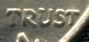

i added a pic of a 1964 TDO Kennedy so you can see what the notches on ther U of TRUST look like
I also added a pic of the S in STATES showing the kind of notch to look for.
Notice that the doubling is not flat.

On the 74D you need to look at the RUS in TRUST, as this is where it can be seen best. You will need a magnifying glass for it though. My goal is to find 100 of these, I have 87 so need 13 more. HH

This is the Trust on one of the 1974 D DDO Kennedys I have. I don't have 87 though!! When you get to 100. let me know, I'll add it to my column in CW :-)
Anyway, here's the pic.
