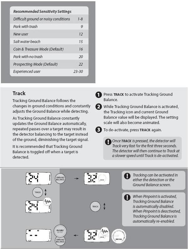

One thing i have to say is do not over power this unit or you will be loseing DEPTH by running the Sensitivity so high LT1stone from what you posted your going way to high thats why Minelab tested the machine and devised the chart, use the chart to get a comparision to the place you hunting.
Example: If your hunting in a Park and your finding tons of PULLTABS run the Sensitivity @ 9

Dave, that is an interesting chart. I may try that my next time out. However, I have a couple of questions. I have been running my X-70 at the highest sensitivity that produces no falsing (typically between 24 and 28), which is what the owner's manual instructs. So far, I have been hunting local parks, which are quite trashy (tabs, caps and foil), and running in pattern one (which doesn't discriminate tabs, but I don't want to miss the gold). I am getting alot of signals, but if I'm not getting falsing (at least I think I am not), then how would I be losing depth running at the higher sensitivity? Also, if in pattern one, wouldn't I still be getting all the tab and foil signals even if I lowered the sensitivity to 9, as the chart shows? Also, wouldn't I be losing alot of depth if I lower the sensitivity to 9? Maybe I just need to forget about gold (still waiting for that first ring) and discriminate out tabs if I want to work these parks. But, even with greater discrimination, won't I be losing out on deeper coins if I lower the sensitivity to 9? Sorry if I'm rambling. Thanks for any insight you might have.

Thanks Dave. It seems that what they are saying is that multiple targets in the ground (trashy areas) will act like heavy mineralization. If I am understanding that correctly, then I can get my head around it. So, if there are enough tabs in the ground it acts like difficult ground and turning down the sensitivity will allow the signal to penetrate better. Am I understanding that correctly?
