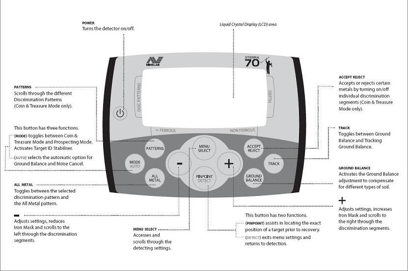

CONTROL PANEL
LCD LAYOUT

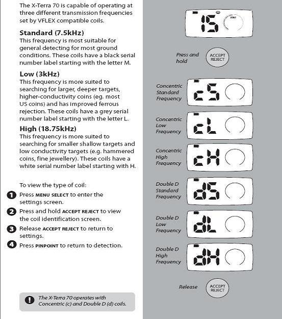

How too tell which coil you have on your machine

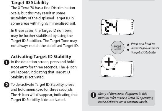

TARGERT ID STABILITY

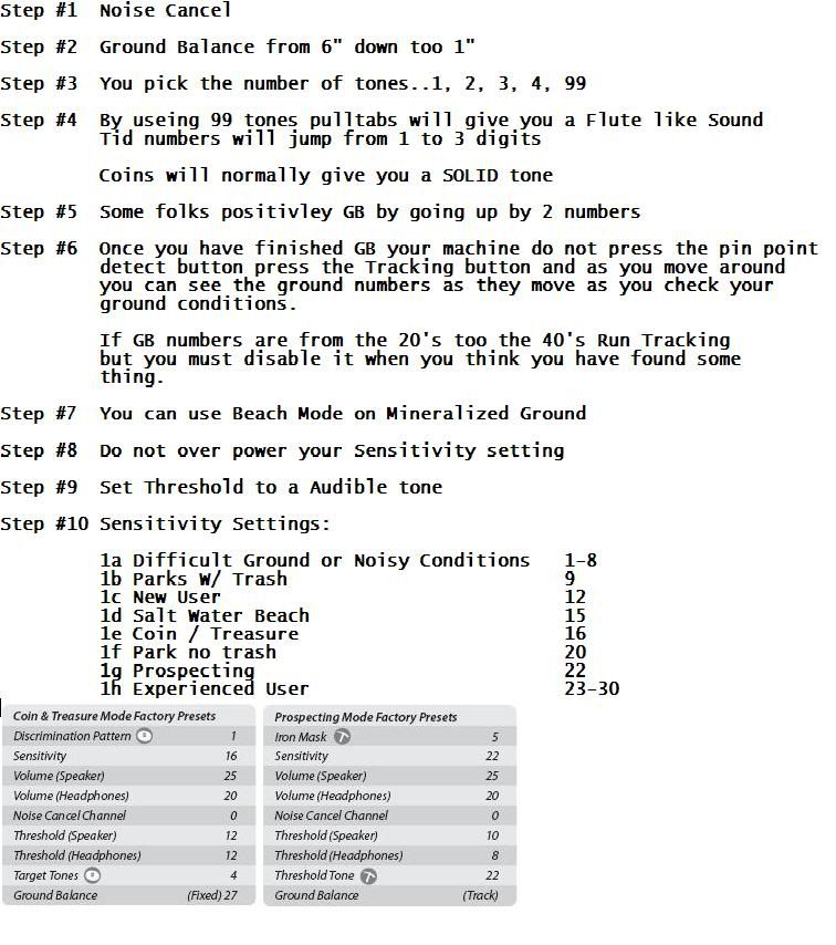

XT 70 SET-UP
How to change from Coin/Treasure mode to Prospecting mode is done by pressing the Mode Auto Button.
Target ID stability is activated by holding down the MODE AUTO button for 3 seconds it may be turned own or off by this method.

Iron Mask default number is 5, which is best left there if you jump from Coin/Treasure mode to Prospecting mode to check & see if you have located a Iron Object then go back.
Use Tracking Ground Balance on the Beach if targets are located far apart.
Some times on the Beach you may have to reduce the SENSITIVITY settings below 15 which is the Default for the Beach.
Tiny ferrous junk targets might be detected when the Sensitivity level is set too high for the beach. Decreaseing the Sensitivity of the X-terra 70 may stabilise it, reduceing false signals and interferance, and assisting in differentiateing between signals caused by soil mineralization and metal targets.
