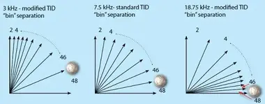

The XT705 has 28 target segments (referred to as "bins"). At lower frequencies, the width of the target bins on the high end is wider, and the bin widths of lower conductors is narrower. Inversely, a high frequency coil will have wider bins for low conductors, and narrower bins on the high end. What this means, is that a HF coil will give a less accurate/jumpy TID on silver, copper, and other high conductors, while being more accurate (stable TID) on lower conductors like gold and lead. And again, the inverse is true. A lower frequency will be more accurate (less jumpy) on high conductors like silver, but less so on low conductors like gold.
Here's an illustration of the differences in bin widths between frequencies.

Also understanding that in mild soil conditions a lower frequency will penetrate the ground deeper than a higher frequency should be included in the equation when making a coil/frequency selection.
