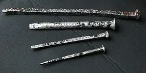

I forgot I had taken some pics in the late 90's before I knew the identity of the wreck. The axle is no longer there...I think the agency that manages this water body pulled it when they got on a "clean-up" kick a few years ago.
Incidentally, without the axle sticking up it took me a week to find the wreckage again...even with the photos!
Also I had a pic of the bottle and jar with some iron we picked up in the shallow water. Do you think jar and bottle are from the wreck?
