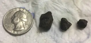

4) And lastly, the source of my insanity the past week or so.... these little ferrous rocks. Our yard has these buried throughout and they're also all over the driveway. Not only does it throw an iron grunt but it also randomly signals as a coin or a pulltab! It jumps all over the place. Is there anything I can do to discriminate out these small rocks without missing my desired targets, which is pretty much anything but these rocks. I've been playing with the sensitivity and notching out the lowest iron signal.

Those are called hot rocks, probably from when people in the area heated with coal or if your driveway was once paved with cinders. Many hot rocks ring in as a high tone, I watch the target ID on my screen and if it is jumpy and I know I am in an area of hot rocks I do not dig it unless I am bored are just have the urge to dig "just in case" I simply hate hot rocks.

Thanks for the replies guys. I typically pull the cover every couple of hunts and wash it out and check the coil. As far as the hot rocks go it's something I'm just going to have to hunt with and learn their language. It's aggravating now but in the end I think I'll benefit from it.
