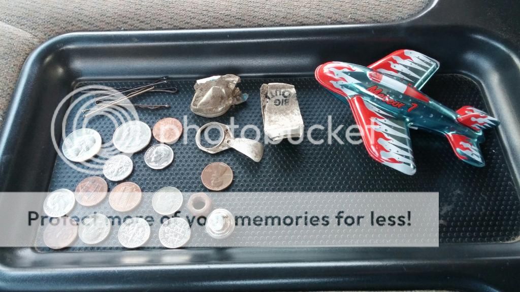

The kids bounty hunter came in today. They wanted to try it so we went to the park. Boy did they love it. VERY impressed with how it operates for kids.
Now I just need my ace to come so I can join in on the fun :)
