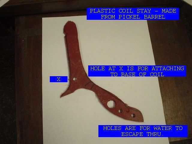

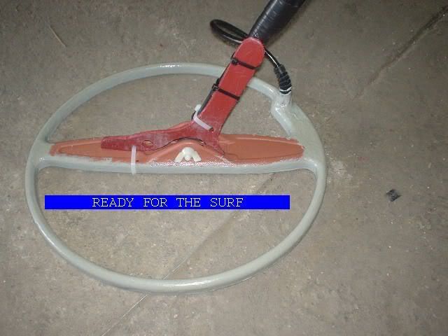

chips - i used a red pickel barrel plastic
i cut out a piece of plastic from the side of a red pickel/grape barrel
shaped it with dremmel.............works ok
good luck
