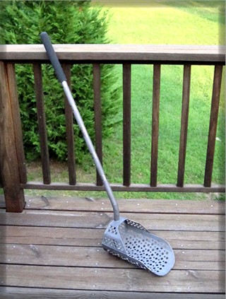

I wanted a wet sand beach scoop to use below the high water mark and hunt the wet sand down to the water at low tide. And maybe do OK in the soft dry sand and in shallow water. But no scoop will do real well at all three places, so you design one that will work the best at where you plan to use it the most.
What I wanted was "simple"... ::)
A real strong tool to give great service without the handle falling off...
Large scoop head so finding a target would be easy to find without digging up the whole beach...
One that would not corrode or rust around saltwater or under most conditions that would shorten the life of the tool...
One that would cost under $100...
Good looks, balanced, and easy to use...
With a good grip and not just a standard bicycle grip.
...And weigh less than 3 pounds!
And with a shorter name than, "BIG HEADED TITANIUM CROOK NECK SAND DIGGER"! :laughing7:

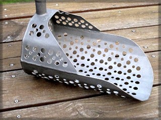

Scoop bottom pan made from .071", top section made using .050", both Grade 5, 6-4 titanium(135,000 PSI tensile strength).
Handle is 1" X .051" wall, Grade 9, 3-2.5 titanium(95,000 PSI tensile strength).
Scoop size: 12"L, 7 3/4"W, 6 1/2"H. Top of handle is 40" high with scoop head flat on grade. Holes are 5/16" and 7/16".
Grip is non-slip, textured(used on high-end exercise equipment).
Weight is 2lbs., 15ozs.
Name: "Ti"(atomic symbol for titanium).
Best at ya!
-Wayne

Nice looking scoop. So I assume it is under $100, will never rust, and did you make it, or buy it?
Re: BEACH SCOOP NAMED... "Ti"
looks good,and I bet he made it.Do u work in a machine shop? :thumbsup:
Maybe add a grip lower on shaft to help pull up, like some people have.

Thanks for the nice comments!
GIB...
The material was bought off eBay over the last several weeks. With scrap titanium selling for $35-$40 a pound, you wouldn't be able to buy new metal
for small projects! I just keep looking until I can find the size and price that will work. I have less than $100 in the scoop... and many hours of labor!
Titanium with match or exceed stainless as being resistant to saltwater corrosion.
SYKO...
I've been a metal fabricator for over 40 years... and have made many things from different metal... but never made any big money! I'll give it a try, may need to change it some?

Yes, if it was made for the surf it would need the top to be longer!

I must have made a scoop that "might work" with all the great comments!
This was a prototype just to put my ideas into something to test to see what problems may need to be worked out, if any?
We are just now hoping to return to beach hunting after not doing it for many years. I needed to replace metal detectors and bought two after reading everything on the web about which ones were good for beach hunting.
I had been studying beach scoops for about two months even before I got the pencil and paper to start a new design that might work better than the ones being sold. I posted this thread to see what experienced beach hunters had to say about the idea and design. And to see if I did something wrong... and to get another person's view to make it better? Even while I was fabricated this scoop, I had other ideas to make one easier to use.
My biggest problem is not having the equipment or a lot of time to do this type fabrication in my basement. The scoop was made by hand and with basic tools.
I bought the scrap pieces off eBay and it took three weeks to get the metal and another three to fabricate the scoop in my spare time. I didn't post this thread to get orders... but I do believe a better scoop with be made and on the market in the future by someone! Just to many problems from people about the current type scoops!

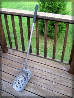

Way to build a better mousetrap! You have a great idea there if you can get it rolling with minimal production costs! Titanium is about the perfect material for the task if you can find someone to do the welds right and economically (good corrosion properties, light, strong). If you wanted to get fancy, titanium has similar properties to aluminum for anodizing. You'd want to think over the pricing pretty carefully to figure in your labor though. I understand material costs were below $100 but it sounds like you put some time into fabrication.

I will agree with all the posts here, I think you may be on to something :headbang: My only suggestion as stated before is to have more top coverage so you can get a good scoopfull without spilling any contents. I think many are in the same boat as far as cost for buying new equipment and yours is the way to go :icon_thumleft:

I have ordered the titanium for a second scoop. This next one will be for my wife. It will be a smaller version of "Ti" with a few changes.
It will also be a test to see how strong and light a scoop can be designed and still dig holes in wet sand. It may be the first 2 pound beach scoop ever made... and work?
I don't think you will ever see titanium scoops made on a large scale production? Doing so, you would need a reliable metal source at a low price. The words "low price" and "titanium" just don't go together!
I would say if scoops made from titanium could be bought from a company the price would be in the range of $450 to $500 per scoop.
I have a good friend that builds scoops for resell. He was thinking about the possibility of making a few? This is part of his email...
"My goal is the perfect scoop if not for sale at least to use. Titanium seems to be closer to that!
I got a quote from a supplier on the net and it about blew my socks off!
Pleased to offer Titanium
.078/.080" x 36" x 96"
1 pc $1760.00/pc
FOB Shipping Point
That is about $350 per scoop in material alone. There's no way I could rely on salvage material an take orders, but I could build a couple of scoops that way. Seems that there will also be some major design changes."
I don't think you'll be seeing to many titanium scoops on the beach? But, if you're on the OBX next month, you might see two!?
