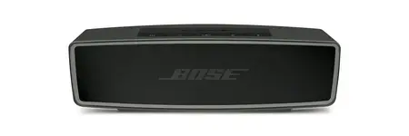

I just paired this portable bluetooth speaker with my equinox.it works perfectly
it could take up to 60 seconds to complete the pairing processes.
