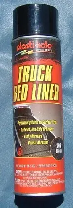

I've heard of three different types of applications to protect your coil: 1) Water proof Epoxy, 2) Spray on truck bed liner and 3) Spray on undercoating.
I've used epoxy on one of my coils and found it to be a bit messy. The epoxy had to be mixed and then spread on the coil with a small brush. I used about a half a tube to coat the bottom of my coil. In some cases I've seen where it takes 3 tubes of epoxy.
Today I opted to check out the undercoating and bed liner spray. On the undercoating label it said that it also deadens sounds in the car when you use it. I decided against this as it may also deaden the frequency going into and back out of the ground. I don't know this for a fact, I'm just guessing here.
I decided on the truck bed liner spray. This stuff is great! You just shake it like a can of paint, hold it 24-30" away from the coil and spray. It dries in only 15 minutes after which you can apply a second coat if you want. It's guaranteed not to crack, chip or peel. You can probably do about 20 coils or more in the time it takes to do one with epoxy. This stuff also comes in different colors. My coil is black so I went with the black color. It makes the bottom of the coil look brand new as it has a nice textured finish. I may even spray over my epoxied coil just to make it look nicer.

The first two pictures are the products I used, the second is the epoxied coil and the last is the bed liner sprayed coil which is my favorite.

Mat ....Over the years I've tried all three including having commercial bed liner shops spray my coils......But have settled on the aerosol spray on bedliner because it's convenient, I can do it myself and it's almost indestructible. I apply it to the bottom and 3/4 of the way up the sides. I feel a little on the sides help protect the coil from rocks. Over the years coil covers have driven me crazy,especially in rough water. Seems like I have to clean them every 30 minutes to prevent falsing. Using silicone to seal the edge of the cover only lasts until it starts to leak. The silicone is a real pain to cut and peel off and time consuming especially if it needs to be done while you're at the beach......rdi

Been there...done that.... they leak and cause more aggravation. Did a very careful job sealing the coil cover with silicone. Used it twice and noticed a small trickle of water coming out from the seal. There was a small pinhole that was invisible to the naked eye, but the pressure changes were enough to force water inside. When I pulled the cover off, there was a significant amount of salt water inside. After that, I epoxied the bottom and added a couple of coats of bed liner to finish it off. Just remember to make several thin coats and allow adequate time for the coats to dry all the way through or it may peel or get damaged if you touch it. (Surface may look dry but may be wet underneath if applied to thick)
