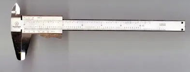

Your caliper is analog, which makes the calculation harder... but your modern blackpowder-shooter bullet appears to measure .530, which means it is for a .54-caliber muzzleloading rifle, such as a Repro of the .54 "Mississippi" Rifle of civil war fame. (I've still got a Repro one, from my Re-enactor years.)
Math is off a bit. That caliper reads .40625 (3/8+4/128).
.40 caliber
Sent from my Galaxy S3
Pardon me, HangnMoss, but I think you are mistaken. To read that type of caliper, look for where the sliding-scale's Zero-mark is, in relation to the "fixed" scale on the caliper's main body. The "lower" Zero-mark is at a teeny bit past the caliper's .525-inch mark, which means approximately .530-inch. (Or if you prefer, the "upper" Zero-mark is at a teeny bit past the caliper's 1/2-inch mark.)
But if I'm mistaken, I'm sure the caliper's owner (Paleopilot) will let us know.
Yep, my mistake, my analog caliper is read from the inside edge.
Sorry about the "old school" Mitutoyo, thank you CannonballGuy for the ID. It just looked different than some other similar bullets. I'm not familiar with the "Lyman Mould" thing either, but I love learning. Thank you again...:thumbsup:
