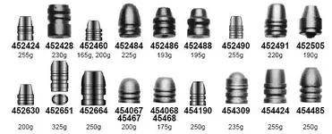

Hey all, thanks to D2, civil_war22, Dust Eater, Davers, and a few others, I searched more and think I have found the closest thing to my bullet in terms of # of GROOVES (2) and top shape of the bullet (rounded) and approximate height of the top rounded part of the bullet. this one is so damn close (cant really tell size diff from pic though).
the main diff is the rounded part of mine does not seem as high, and the base on mine does not come out in diameter from the bottom of bullet (it is flush to rest of bullet)
maybe someone can fig out more now (type of firearm, if civil war, and if not, approx age, etc).
here is the pic i found, and the website for it below:
close one to MY bullet is BOTTOM row, 4th from LEFT. when i saved the pic, was named 45 colt
web site: Paco Kelly's Leverguns.com ? View topic - Best .45 Colt Cast Bullet type - Levergun / Revolver?
pic using 45467 bullet as search in Google (was # under bullet in prev pic above), not my bullet does NOT have reed lines in grooves, not sure if this one does, think just the lines in the pic
MY BULLET (below) (clad dimes are for sizing)
I would say that bullet Id is spot on.
it's pretty darn close. would date this post civil war, but not much, IF SO i guess.
Yea just right after. I'm not sure on the round ball though. Heck they've made them since the invention of the firearm so hard to tell.
