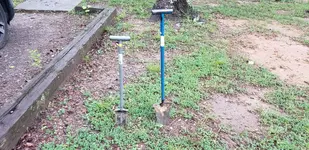

Finally, regarding the Lesche Sampson, I am not sure if we are talking about the same model, but I would not use my Sampson on a relic farm field. The blade is too short and narrow to dig a decent plug in a red clay corn or bean field to be effective and efficient. Like I said, in a park or lawn or local woods without a lot of roots, it does great. But my (all metal and welded) Predator Pirhana just moves A LOT more dirt and starts a much deeper plug, plus the blade is serrated. I have a larger WW Manufacturing all metal D-Handled Spade for heavy duty work. Smokey hates it when I use that shovel because I tend to clang it against trees and rocks because I am a clumsy oaf and make too much racket (plus Smokey knows when I bring that thing out, I mean business) LOL.
See comparison pics below of the Sampson (small gray tool) vs. the Pirhana (large blue tool). Don't have access to my WW Shovel on the road, but it is a lot bigger. All are quality, all metal welded, and rugged products that are up for the tasks and abuse that come with relic hunting.
