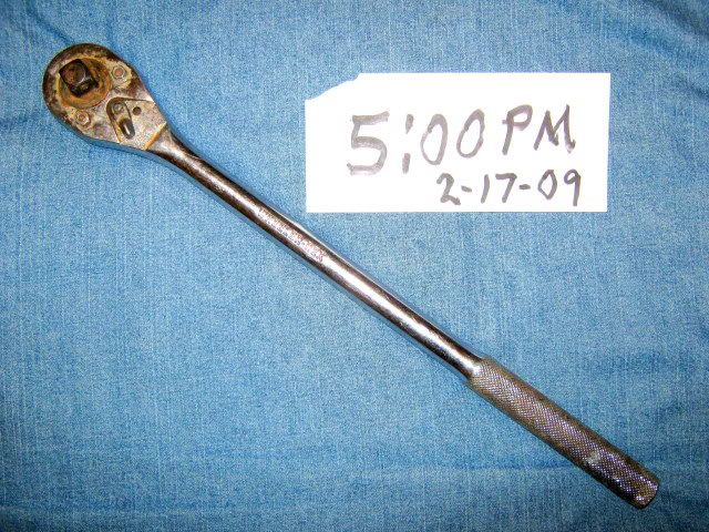

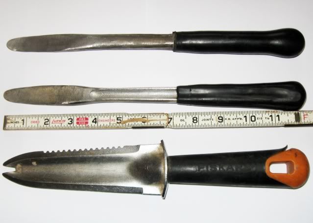

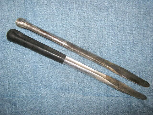

I have designed my own hand digger. There are
ready made diggers that are close, but no cigar.

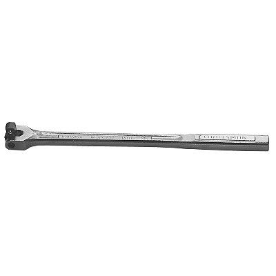

My best one is fabricated from a Craftsman 15
Inch breaker bar,
The second one which works just as well is made
of a 15 inch heavy duty 5/8 inch drive ratchet.
They are unbreakable under heavy use and don't
need sharpening.
These things will dig the toughest, if you can dig
the toughest.
When making one of these,
remember to leave a rounded knob on tha other
end to make tha end of tha handle more rounded
for comfort.

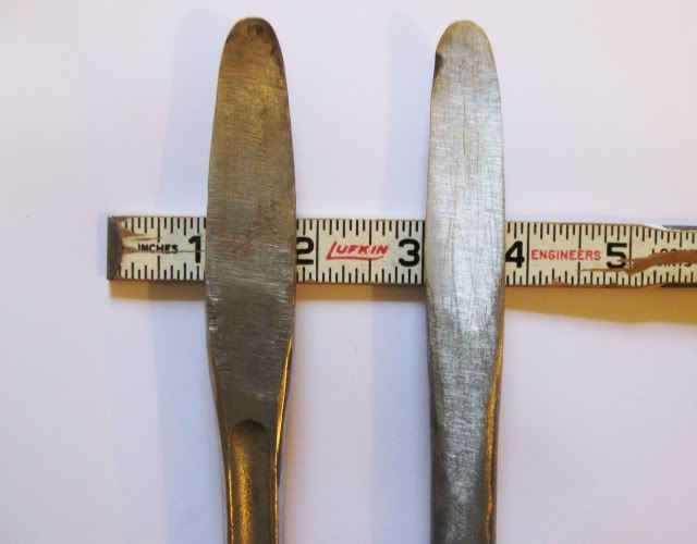

The over all finished length is about 12". About tha
same as tha Fiskars digger.

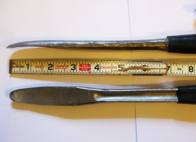

The "length of blade section (tip to grind blend-out)"?
That is hard to say?
Try using this photograph as a reference,
Tha handle is about 5" long,
And yes, the handle of tha ratchet becomes tha
blade of tha digger.
Tha Craftsman makes a 1/16" wider blade because
tha handle is flatter,
But in actual use, I found that makes no difference.
I got this 15" ratchet at a pawn shop for $4.
After three solid hours of grindin, I had it roughed out,
Remember ta keep dunkin it in water ta keep it cool !

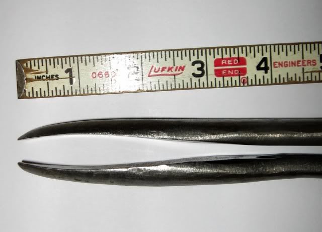

Maybe this photo will help show tha subtle shape of
tha blade,

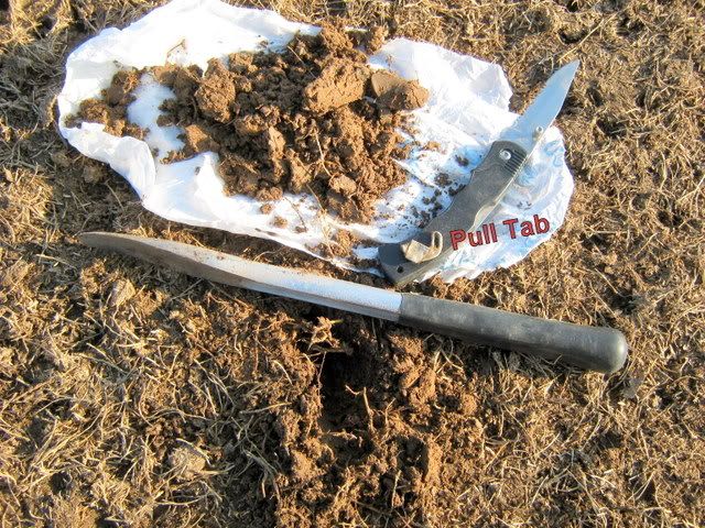

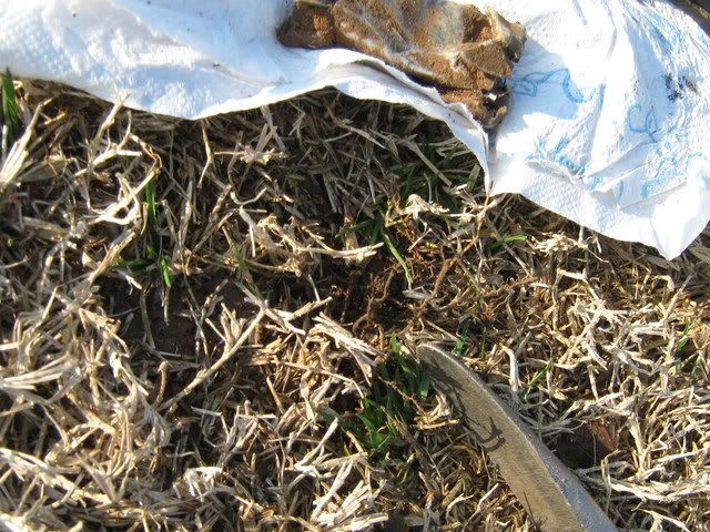

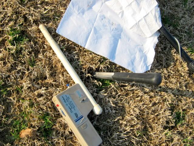

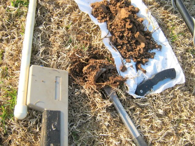

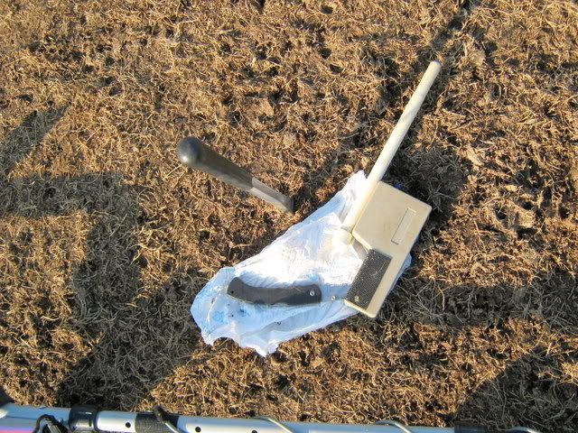

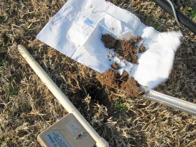

Here’s a demo of my Arkie Digger,
I can dig 8" and pull a crushed soda can out of a hole I have to
stretch to get it out of. I have an improvement on the screw driver.
It will scoop dry dirt out of a 2" hole. All I need is my Arkie digger
and an electronic pin pointer.
I'll Let Tha Pics Speak For Themselves
Happy Huntin,
Tabdog
That is the biggest pin pointer i've ever seen. Do you still use a bag phone?:laughing7:
