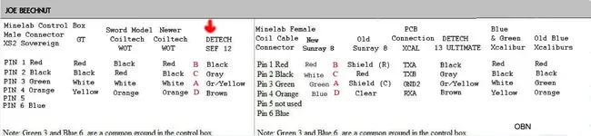

The detech ULT13 is a Hot coil, very noisy in the water. ON the 10 x 12 SEF (and larger SEF's) I would check the wiring on that, I seen "Many" a few years ago that were wired wrong. And they were wired wrong because there was a incorrect diagram out there. They were fine on the dry and wet sand but once they hit the water. You could not hunt with them they were so noisy. My guess is there were several hundred done wrong since a dealer in florida used the first diagram pictured.
Wrong wiring on the SEF 10 x 12, Diagram
Then the Correct....Black..Gray..was switched and they worked correct.
