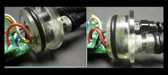

Are they physically larger than the Amphenols (like you see in OBN photos)?
Has "LTT" mark on the side but I've never heard of the company but looks good in photos.

The above Waterproof IP68 are in-line connectors, not panel mount as OBN's.
Physical size is approx. 3/4 diameter over center and 3 1/4 long when assembled.
As you can see I have a wrap of electrical tape around the connector and I have also affixed the connector to the shaft with a wrap of electrical tape.

On the excal photo there is a rubber o-ring that helps keep the water out of the threads - but on the CTX the connectors are spaced out more and there is just the one inside the female. The 3M look good as long as the second o-ring stays there...
