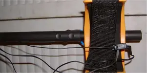

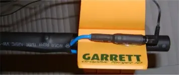

This is not easy. Find a lathe and a milling machine and some thick wall aluminum tube or solid alum bar. Turn O.D. to about 0.800 for 4" and step down to about 0.680 for about three inches, to engage I.D. of the factory tubing. Holes for armrest are 0.406 dia, spaced about 3/4" apart. A pop rivet and now it's perfect. I have added about 2.5, 3.25 and 4.0 inches range of extension. I like midpoint at the 3.25. This can be done with other materials and a bit of ingenuity, but the 0.406 dia holes and the 0.800 O.D. and 0.680 dia step are a must for the best fits. Also, the farthest extension for the coil is too long except for the really tall guys. I put my coil extension at the fifth hole, and its just right. The balance is much better and it feels like the weight has been cut in half. Garrett, please consider an extension kit.

Great job on the modification. There sure is a lot of talent here. :thumbsup:
Thanks John, I appreciate your comment. I did not do the machine work, but I did the design and had it made. I think most people can rig up something similar with a bit of scrounging around. This could readily be fashioned from a strong wooden dowel with a drill and some whittling and sanding.

I just googled the gizmo, this looks very similar to mine. I would prefer a pop rivet over that big nut and bolt. I say the price is a bit too much, but well worth it. This needs to be tooled up as a fiberglass filled plastic injection molding, and offered by Garrett. I cannot image for the life of me why Garrett makes the shaft too short on the arm end. It is my opinion that the coil end of the shaft is much too long. ???

khouse, I must correct myself, mine looks very similar to yours. I never saw yours until this post. Form certainly follows function. If I knew about yours, I would have bought one from you. Getting mine fabbed up was a royal pain in the arse, I was lucky and had the work done by two machinist friends at no charge. I can say that 35 beans is a good deal, the pain in the wallet will soon vanish after the Gizmo works it's magic.
