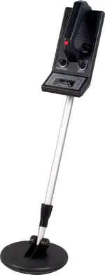

I'm new to metal detecting, and I'm a soon expectant owner of an ace 250, and I would like to know what your experince with the ace's are, and your finds.
What tips, and advice do you have. On a scale of 1-10 how accurate was your detector, far as depth, and visual on screen accuracy on an object. What is the maximum depth you have detected at. And do you prefer rechargable batterys, or just standard batterys, and how long do they last.
My friend owns a lower end detectors, like the one I'm listing below, he use's his to find nuts&bolts, and things he looses in his yard, how would the ace compare to one of these anolog style jobs. Thanks

the ace will annihilate the toy in the picture! on a scale of 1 to 10 on accurate ID, i will give it an 8.(which is comparable to some higher dollar machines). deepest depth on a coin was about 8 inches but that was a rarity. 4 to 6 was much more common. it is a hell of a machine for $200
