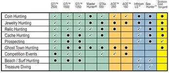

Garrett designates the ace as a coin shooter. IMO it will perform best if you don't try to buck this and use the coin setting. It will still hit on all silver using this setting and probably 50 percent of gold items which will ID as nickels.
Re: Garrett Ace 150&250 owners
Thanks for the chart, looks the me like the ace has all the important areas covered in my book, and most every elses also.
