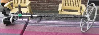

Hi guys
I hunt with the attack nel coil but it is heavy and I have a new shaft made
Its working fine but I can fold it and is difficult to transport see pictures
now I want to use the shaft of XP but the cable is too short because the angle of the handle
see pictures
Can someone help me to an waterproof extension cable
Sorry for my bad English
Thanks and HH
Greetings Antonio
NetherlandsIMG_1466verkl - kopie.webpIMG_1468verkl - kopie.webpIMG_1536verkl - kopie.webpIMG_1537verkl - kopie.webpIMG_2807.webppro.webp
antoninvs
Increase the cable. Connections to solder. Insulate the connection cable with tape.
