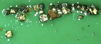

Did a few minutes of digging around a quartz vein today; I ended up with this in the pan. It is heavy and gold in color. Hoping its gold but I haven't seen any posts about gold with ironstone attached to it. I am soaking it in CLR to see if it will eat off the iron. Does anyone know how long I should soak these little nuggets? If this is AU then I hope I have many days of finding it ;-) I spent at least 10 minutes digging around that quartz vein with a hammer, so if its real I'm pretty sure that would be a good take. What do ya'll think?:hello2: Screen Shot 2015-05-23 at 5.38.22 PM.webp

Thought I'd try separating the iron first to see if I can get clean little nuggets. But I don't know if the CLR will do it it has removed quite a bit in the last half hour. have a few that are cleaning up. Sure hope it works, this way they'll have their natural shapes. Here's what it's starting to do..

Got impatient & decided to crush with pliers.... The black stuff turned to dust. I did get a few small specks of gold... but they were all small (no nuggets). But just finding a little was great. :icon_thumright: Hopefully I'll find more next time guess I better put a little more time into the hunt.

While there may be some fine Gold trapped in the specimens, it appears to be mainly Iron Pyrite!

Smash it with a hammer. If it's gold it will flatten out. If it's pyrite it will turn to dust. As far as gold being covered in 'ironstone' (assuming you meant magnetite), the process for gold depositing in a vein is one of precipitation from a hot chemical soup. That chemcial soup deep in the earth is like a pressure cooker with a lot of things in it like chlorine, sulfur, etc., which will dissolve gold especially when pressures are very high and temperatures are high. Once dissolved (along with a lot of other minerals) the hot water may rise closer to the surface and cool some, hitting a zone where it is cool enough to precipitate out. In this zone as it precipitates out, other minerals may also be precipitating (becoming solid like a crystal growing from solution), like quartz, magnetite, pyrites, copper, silver, etc. So the crack in the rock layer that it moved up into from below (often an uplift fracture, the vertical cracks you see in large rock deposits caused by stress relieving when part of the rock moves more than another part of it nearby) will eventually get filled up by all these minerals, with a particle of magnetite growing into a mass right next to a lump of gold or silver or whatever else is there.

Pull a bigger sample and crush it all then send it through a blue bowl or carefully pan it. If there is gold it will show up.
If you want to try some nitric acid you should get a reaction on the pyrite and it should eat the iron (or manganese) coating off the gold but wont touch the gold
Gold does not shatter, pyrite does
If there is gold you will have to liberate it from the pyrite and other minerals. You can crush and separate with highly efficient gravity methods,or leach or flotation or amalgamation or you can smelt the ore.

I would do your own work first before paying for an assay. If you have free gold you can find it. If you have sulfide you will have to smelt it and just having to do that may make you choose a different place to dig because of cost and effort.
