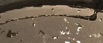

I didn’t expect much as this is my first time using it and I was at home. Followed capt nemo’s directions on how much sand to put in the pan and stratify. Picked up 2 tiny gold specks. I was impressed as I wasn’t sure if I stratified long enough or if I let too much sand go out. So far 19561ECB-9FAA-4B3B-B510-B738C8D336B1.webpso good. Can anyone please tell me what mesh size the gold specks are. Thanks

I did a quick 1 gal. of sand pan this morning. Plucked out 3 colors.
30C0C7CE-9275-40E7-98DF-8A7A52B1B96B.webpWent to the river today and classified a 5gal. bucket gravel sand to 1/4. I panned the sand with the flowpan in the river and brought back the concentrate to pan at home. Was surprised to see over 30 colors at the bottom of the pan. Flowpan works well on the tiny gold. Next time at the river I’ll try unclassified material and see how that goes.
View attachment 1710079Went to the river today and classified a 5gal. bucket gravel sand to 1/4. I panned the sand with the flowpan in the river and brought back the concentrate to pan at home. Was surprised to see over 30 colors at the bottom of the pan. Flowpan works well on the tiny gold. Next time at the river I’ll try unclassified material and see how that goes.

On Tuesday I flowpanned 5 buckets of unclassified at the river. Didn’t do too bad.
