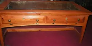

About 3 or 4 years ago when "cabin fever" set in. . . and the wife kept asking:
"What are you going to do with all this 'stuff' (not her exact words LOL) you've found". . .
so, I spent a week building a coffee table with a plate glass top.
I spent about a week of time and maybe $175 on wood (oak) & glass.
Oh, I took these photos BEFORE I ordered the glass.
It was a fun project. . . you should have fun!

I really like it, nice job!!!
