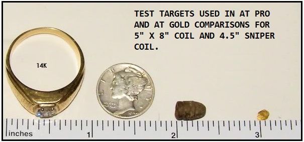

TESTTARGETSCOMPLETE_zps7287c0a0.jpg~original
Intermittently switched the 5" x 8" DD coil with the 4.5" Sniper coil on both the AT Pro and AT Gold. Both were set at maximum sensitivity. The AT Gold was ground balanced to 33 and the AT PRo to 85. To maintain a high level of reliability, the air tests tests were done outside, away from the house. I removed my watch, rings and change from my pockets. Distance was set at a strong repeatable signal strength with a moderate swing speed. I also did a test run using my favorite coil, the 9" x 12" Concentric coil.
Although in most cases, the larger coil got more depth then the sniper coil, the difference was minimal with the tiny gold flake. The sniper coil should work fine for tiny match sized gold nuggets. The sniper coil is still a preferred coil to use in playgrounds, especially close to metal equipment. It is also good for hunting in extremely trashy areas, along fences and along re-bar.

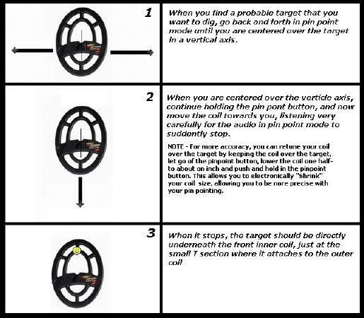

Garrett's Searchcoil Tech Sheet | How Searchcoils Work
smallerinstructions2.jpg~original
