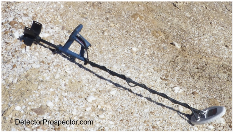

Hi Just Curious,
From your description, it looks to me that you’re getting erratic false ground signals typical of searching highly magnetic susceptible black sands when your sensitivity is set too high.
We can readily use high sensitivity settings to search over mild-to-moderate magnetic susceptible iron-mineralized ground minerals without incurring false signals as a rule. Such ground conditions permit a relatively wide ground balance window, which means that there is more room to lower or elevate the coil without inducing false ground signals. But in soils dominated by magnetite (re: black sands) or maghemite iron minerals, that window is greatly reduced. Thus even small changes to your coil’s elevation can induce false ground mineral generated erratic signals and hence we are obliged to operate at reduced sensitivity settings.
Therefore, try to operate with your searchcoil at a uniform elevation above the ground as much as is possible, and to reduce your sensitivity until you can satisfactorily mitigate or eliminate the false erratic ground signals that you have been experiencing.
On a different note, the Gold Monster’s automatic ground tracking should detect most small gold within range of the searchcoil’s electromagnetic field but it isn’t the most effective tool for detecting tiny gold that is situated at the fringe of detection depth. This is precisely why most prospecting-capable units do possess a manual ground balance feature that enables you to fine tune it to the ground mineral conditions, and to effectively deal with areas littered with iron trash so typical of mining country.
Automatic ground tracking isn’t a good tool to use in iron trash littered areas because the ground balance software is constantly adjusting to variable ground phase readouts from rusty and / or disseminated iron, immediately followed by trying to readjust itself to the actual ground mineral conditions. In such scenarios, the detector will frequently be completely out of proper ground balance with the soil, and some small gold, particularly the marginal deeper signals, will be ignored.
One thing more, if you continue to re-sweep typical small gold signals while using automatic ground tracking, it is likely that such signals will disappear because they’re simply ground-balanced away. So ensure that when you evaluate signals by swinging the searchcoil back and forth over them, in the absence of any feature to disable the automatic ground tracking, that your coil sees plenty of ground on both sides of the target signal.
Hope this is helpful to you, take care. :)
Jim.
