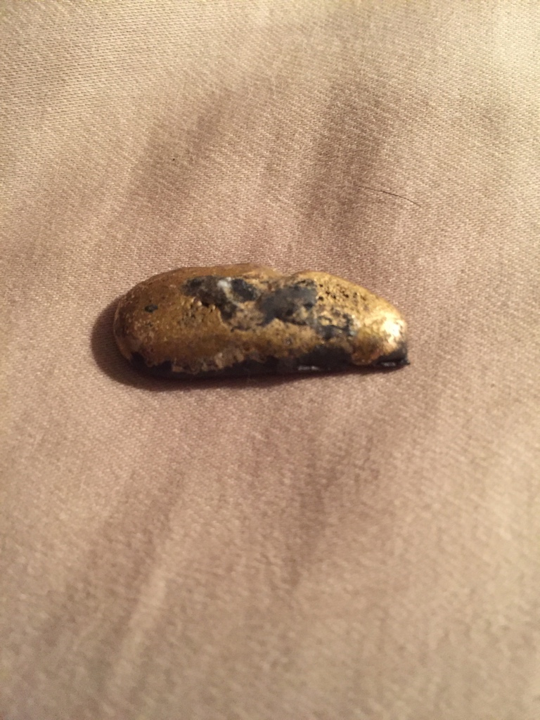

I'm very green at this point and melted down some gold and it has black in it and I'm not sure why. Can anybody help me out on this?

Impurities. Unless you know what they are, they can be tough to remove. You'll essentially need to dissolve the impurities, but leave the gold. If this is simply carbon from the smelting, my understanding is that the old-style dry cleaning fluid - CCl4 Carbon Tetrachloride can remove it... But that stuff is nasty, and extremely hard to get a hold of.
Other folks have had some success with industrial strength toilet bowl cleaner... It won't harm the gold, but it won't be shiny when you're done.
Have you tried polishing it away? Wrap a drill bit in cloth, and use some polish on it. Then turn on the drill and slowly work the gold button around on it. That might take it off.
Best of luck to you.

Might I ask why you melted your gold? Also, what was the original form prior to melting?
You just lost money. You will have to pay an assayer to test for purity before you sell it (if that is your intent).
Did you use a crucible or just torch it?
I melted a wedding ring given to me by my X. Wanted to make it look like a nugget by melting and dumping it in ice water. Had no real idea to what I was doing, so melted it in the same pot I melted lead to cast bullets. The pot had some rust in it, and the rust turned the gold pink. My suggestion is if you have never done it, look into the proper way, because I didn't know what I was doing, and ruined some gold for what I was trying to do with it.

It is scrap jewelry and I melted it because I wanted to do it

Well I looked at a couple of videos on YouTube it didn't look like it was rocket science. I hope I didn't ruin it it's 18 karat

I used the crucible with a mini furnace

Nahhh.. you didn't ruin anything. If you ever want to sell it, just send it to ARA gold in Texas. The refinery pays 98% of spot (after refining). No assay required. They'll just dissolve it and then send you a check. :)

Gold is gold! Melted or not it is the same metal. Sounds like a fun project to do. You would lose the same amount of money selling it to the assayer as you would if it was in jewelry form. That is, if you are planning on making it into 24k gold.

I not the right person to ask. I'm pretty new to this. I was told not to mix. Learn all the tips to pouring, heat and grease the mold right before the pour. I didn't and the gold chunked up when hitting the unheated mold. Good luck and God bless.
