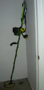

made my own.its simple if your a handy person,painted her greeeen.all your paint handles and broom sticks and such "dont"work diameter of tubing is not the same tried 3 or 4 of them.you need 7/8in. dia all the paint handles and broom sticks are 3/4in or 1in..ace hardware some carries 7/8 .home depot and lowes "does not".if you want to go high tech use "titanium" tubing stronger and lighter,and cost alot more about $20 a foot or so.my rule of thumb standing straight up with coil should be almost tall as you
