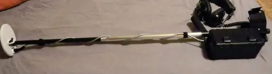

After trading off my INfinium(I hated that thing!) I was lacking a water machine for this summer. After talking with NAD several times and checking out the Compadre, I figured I would make one as well, that way NAD and I didn't have to fight over it . Finally got around to getting the water proof boxes and my Compadre in I went to work on it. Got hold of some cable glands and some SS hardware I finished it up last night. Went searching through my basement for a straight rod, I did not like where I would have to mount the box on the stock shaft. I ended up finding an old extending car wash brush, perfect diameter aluminum shaft on it. It could be 6 inches longer, but I think I will order a couple of sections of aluminum tubbing to accommodate my height. Hope to wire NAD's up this week for him. Here are a few crappy camera shots of it completed, I figure I will get some windshield sealant to seal the cable glands and mounting hardware just to be safe, not that I plan on diving with it or anything, but it will do for what we are going to be doing with them.

Chad stopped over with his unit.. Impressed, super professional job..I am going to have to build mine the same way, since the standard Tesoro shaft causes the box to be mounted very low..Unit weight is now 3.6 pounds... One interesting thing is that when you open the Compotter to turn it on, you can stash your keys in the box. Getting them out will remind you to turn the unit off. If anyone has a set of U'W phones for sale, Chad can use them...My machine will be a loaner, but I expect something left as security Tejon. Etrac, T-2,.AR-15...Us old timers can get hard nosed about people taking care of our stuff. :icon_thumright:
Found a program to make the pictures smaller.Chad and the Compotter.Sort of looks like a 60's model detector..Mine is splattered all over my work bench...Wonder how many pieces I can leave out and have it still work..
